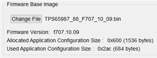

Part Number: TPS65987D
Other Parts Discussed in Thread: TPS65987

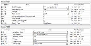

Config:
TPS65987D
PP_HV1 = 5V fixed
PP_HV2 = 9V fixed
Source DFP
Sequence of events:
Proper TPS65987 source cap reporting
Sink requests PDO1
TPS65987 supplies PDO1
Sink requests PDO2

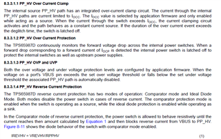

All looks well until there is an unexpected hard reset
What might cause the reset?
