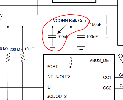

Hi Malik,
Here's few questions!
1.Does the bulk cap can use MLCC
2.Can several capacitors be placed in parallel to achieve the required capacitance?
Thank you!
Scott
Hi Malik,
Thanks for reply. Just curious that why the single cap is recommended?
Thank you!
Scott
Hi Scott,
Larger capacitance is better to reduce lower frequency noise on power supply. Smaller bulk capacitance only helps with higher frequency noise not typically seen on power supply's and already covered by 100 nF.
