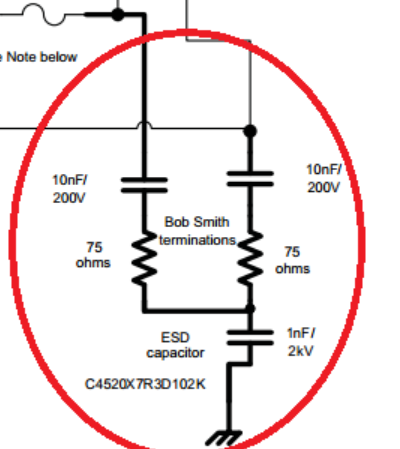

I'm looking into a Bob Smith termination for a Power over Ethernet (POE) PSE. As per TI application note i find below termination.
I understand 10nf is for dc blocking. Can we interchange the 75 ohm resistor and 10nf cap. Does it make a difference?
