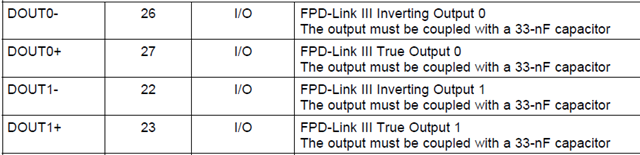

I use a DS90UH947.
I only use DOUT0+/- of it, so how should I deal with the unused DOUT1+/-?
Leave it float, or couple with 33nF?
Thanks.

Hello Xinyue,
For unused 947 FPD outputs, please leave floating
