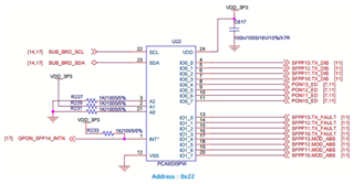

  • HI JH,
    Can you provide a schematic of the PCA9535 for me to check?
    How many units/boards does this issue occur on?
    Are you doing any temperature testing with the device before power up?
    -Bobby
  • Hi Bobby,
    Here is the customer's circuit.
    This symptom occured with MP products and there was no temperature testing.
    The customer used 5 PCA9535s in one system, 3 applied to the main board and 2 to the sub board.
    The symptom only occurs with 2 PCA9535s on the sub board and occurs 1~2 times out of 10 power-ups.
    JH
  • Hi JH,
    I don't see anything wrong with the schematic.
