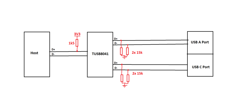

In our design we are using the TUSB8041 connected to a Qseven conga-QA5 host. Occasionally (1/50) when we boot up the device the USB 2 hub within the TUSB8041 does not get recognised. The USB3 side it working fine.
We have the following setup:
According to all my research, the pull up and pull downs are there for speed detection. USB HS uses the same configuration as USB FS which is the pull up on the D+ line which is why we have that on the UFP for the hub. The DFP can be either HS/FS/LS so these need pull downs to allow the connected device to negotiate the speed.
According to all the forum post I have read, the datasheet for the hub and the EVAL board, these resistors are not present, yet there is no reference anywhere that these are internal to the TUSB8041.
Before I start removing them from my boards completely, could someone please confirm that these connections are not needed and the TUSB8041 has internal pull up/down resistors or constant current sources on the USB2 D+/- pins.
