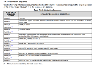

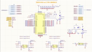

SN65DSI83: DSİ LVDS Converter for sdm660
Part Number: SN65DSI83
Hello, I'm trying to connect a tablet display panel to a sdm660 processor card. I use sn65dsi83 to convert dsi to lvds, but I couldn't get the screen to work. Test patten appears on the screen when I make the settings, but I don't know why the test patttern works. I want the screen to work normally. Can you please help?

The PLL_EN bit and SOFT_RESET bit are not set as they need to be set per the recommended sequence defined in the datasheet
%CHIP1%PVCA%PMCA%RPCA1280%RLCA800%PVCB%PMCB%RPCB%RLCB%LVCM0%HPWA54%HBPA54%HFPA52%HACA1280%HTOA1440%HPWB%HBPB%HFPB%HACB%HTOB0%VPWA8%VBPA8%VFPA7%VACA800%VTOA823%VPWB%VBPB%VFPB%VACB%VTOB0%PCKN71.1%LCKS1%RCKM24%MULT2%DCKA%DIVI0%LCKR72.0%FMTA1%DEPA0%HSPA1%VSPA1%BPPA1%FMTB1%DEPB0%HSPB1%VSPB1%BPPB0%PRDA1280x800%PRDBx%DSCM0%LREO1%LRCE1%LPCA0%BMCA0%SMCA0%LPCB0%BMCB0%SMCB0%DHPA54%DHBA54%DHFA52%DHAA1280%DHTA1440%DHPB%DHBB%DHFB%DHAB%DHTB%DVPA8%DVBA8%DVFA7%DVAA800%DVTA823%DVPB%DVBB%DVFB%DVAB%DVTB%DDRA213.3%NOLA3%VIMA2%LCRP%DDRB%NOLB0%VIMB0%RCRP
    Have you used DSI Tuner SW to generate the DSI83 registers programming value? Please see attached DSI Tuner SW.
    5383.DSI Tuner 2.1.zip
    Once we verify the power up sequence is correct, we can then verify that the video timing output from your processor matches what you are programming into the DSI83. You can take a look at this e2e FAQ on how to do the measurement using a scope.
    https://e2e.ti.com/support/interface-group/interface/f/interface-forum/852871/faq-sn65dsi84-no-display-output-with-sn65dsi83-sn65dsi84-sn65dsi85
    David
  • I was able to set the lvds frequency 72 khz. So I can write data to registers. But 0x09 and 0x0d also give error
    why am i getting this error
  • HI,
    If you are getting the error of writing to register 0x09 and 0x0D, then this is a different error from the LVDS error you are getting. Can you please share your DSI83 schematic and the panel spec?
    Do you have pullup resistor on the DSI83 SCL and SDA pin and have you tried to change to a different pullup resistor value to see if it helps to solve the I2C error you are getting?
    David

  • I think I have solved the problem of writing 0x09 and 0x0d registers, but I am not sure of the correctness of the registers, can you please check?  I am sharing dmesg outputs. MY DRİVER NAME mipi_convert

    You can refer to the DSI83 initialization sequence for register 0x09 and 0x0D as shown below. Step 6 and 7 is when you set these two registers.
    David

    LP11 is a MIPI DSI state, it is a Low Power 11 state where both single-end signals on each lane are at held at signal level 1 which is 1.2V.
    David

    The soft reset bit is W/O so it won't stay at "1" after being set:
    What is the time delay below the register reads, it looks like you are capturing before and after the PLL is enabled, is that correct?
    JMMN
