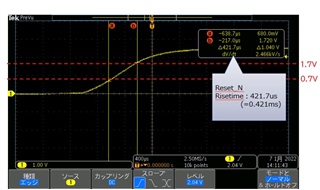

Hello Vikram
We tried other rise time 0.42ms. It is able to work LED.
So we would like to clear the reset_N signal Logic(Spec) in the LSI.
Edge trigger or Level Trigger? And rise time spec.
Kosaka

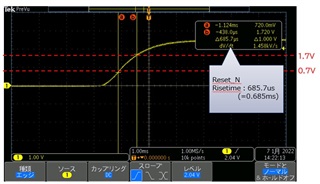

We share the waveforms. And remesure at Low voltage and highvoltgae timing.
LED NG case.
LED OK Case.
Could TI judge the LSI spec from this waveform?
Kosaka
Looking at the waveforms shared standalone, I dont see a problem with reset rise/time. May be it has to do something with the moment you are toggling resetn. To understand that can you share what LED functionality is being looked at? Is it something related to straps? Does this reset toggling happening at time of power up or later?

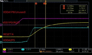

I did not get what was the desired functionality of LED. But I understand that when you observe a little slower reset, you also read all F. Is that correct? Do you also have snapshot of the supply of the PHY in the bad case? May be it has something to do with the way supply is ramping and not the reset (as you mentioned that reset is toggling at same time as power-up). Do you see a flat region in the supply ramp or slow ramp of supply voltage?
As a work-around, can you try toggling reset one more time after the supply is stable and may be it will recover the PHY with this extra reset outside the power ramp period.

Supply waveforms are ok. I dont see any glitch or non-monotonic behaviour on them. Also I noticed that resetn is toggling very close to supply getting stable, so resetn should not have impacted the PHY as in this period PHY is under reset due to internal power on reset. So it does not look like that resetn can directly impact the PHY. Are we sure that the resetn's not because of something else on the board? Example : is resetn also going to the SoC which is reading the PHY registers?

Hellow,
Soc outputs reset signal for Phy. When we change the SOC boot timing,it can read it.
So This resolved my issue.
Thank you for cooperation.
