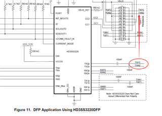

Hi team,
In the HD3SS3220 dataset, the type C interface has the same hardware connection when UFP and DFP.
Both are HD3SS3220's TX2P/Tx2n pins connected to TXP2/TXN2 of the TYPE-C connector. See the figure below.

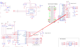

But in the schematic of the HD3SS3220 DFP Dongle Evaluation Module, The HD3SS3220's TX2P/TX2N pins connected to SSRXP1/SSRXN2.
May I know if the TX2p/Tx2n pins are input or output? Or is it automatically assigned as input, or output, depending on the different mode such as DFP and UFP?
Could you give some comments?
