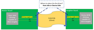

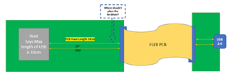

TUSB212: PCB Layout Guidelines for USB Redriver placement
Part Number: TUSB212
Need help on USB Retimer option. My Host says the routing length of USB2.0 trace is 10cm .Where should i place the retimer TUSB212? Does the device capable of retrieving the lost signal on the trace if place beyond the acceptable limit. I need to travel 30cm .Kindly suggest on how and where to place my redriver on PCB.
