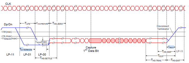

Hello, Team,
Could you please tell us the difference of "TD-TERM-EN" and "THS-PREPARE" in terms of waveform observation point?
Our customer is now evaluating AC timing of MIPI-CSI.
"TD-TERM-EN" and "THS-PREPARE" have a different specification (with different min/max value), but it seems to be showing the same period in the timing diagram:
Could you help us here by giving us instructions so that they could capture the correct waveform?
