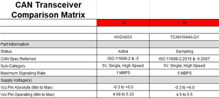

Customer is looking for the HVDA553QDRQ1 & TCAN1044AVDRQ1!
Could you please help provide comparison table of HVDA553QDRQ1 & TCAN1044AVDRQ1 ! THX

The 8 Pin comparison matrix on our internal sharepoint includes both of these devices. Let me know if you need help finding this document.
In summary, TCAN1044A features faster maximum signalling rate (8Mbps), expanded operational supply range (±10%), and lower loop delay times.
One primary difference is the use of pin 5 which is a NC or Vio ('V') pin for TCAN1044A. If replacing HVDA553, a non-V TCAN1044A should be used so that the SPLIT line will be connected to the NC pin.
Note that the specifications in this table for TCAN1044 also apply to TCAN1044A.

I have found comparison table of HVDA553QDRQ1 & TCAN1044AVDRQ1,THX
