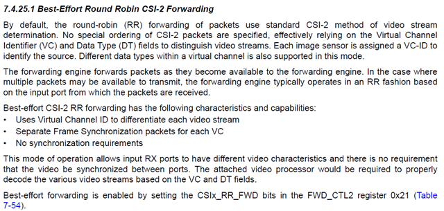

Customer is using 4 cameras connected to 4pcs UB953, and then transmitted to UB960 with below CSI-2 timing, can you help to check which CSI-2 Forwarding mode should be selected for UB960? Thanks.
Customer's MIPI CSI-2 format:
  • Hello Jacky,
    What is the customer trying to do? Does their system handle multiple VCIDs (virtual IDs)? If it does, then you can just use the Best-Effort Round Robin CSI-2 Forwarding. Are they considering synchronized CSI-2 forwarding?
    You can learn more about it in section "7.4.25 CSI-2 Forwarding" in the DS90UB960 datasheet.

  • Hi Shruti,

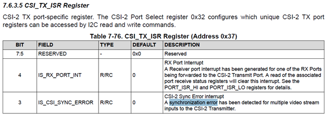

    Thanks for the reply, and yes customer used the multiple VCIDs where all 4 cameras used the same ID connected to UB953, and then connected to UB960. Customer tried all 3 forwarding modes for UB960 including Best-Effort Round Robin CSI-2 Forwarding and synchronized CSI-2 forwarding, but their SoC is still reporting below error:
    "a non-synchronizable SOT (start of transfer)error interrupt during HS reception)"

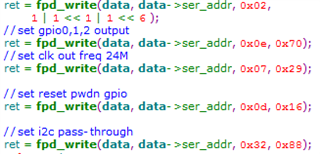

    Below is customer's software configuration for UB960, can you help to check if there is any issues? Or is there any other configuration needed for this use case?
    Thanks.

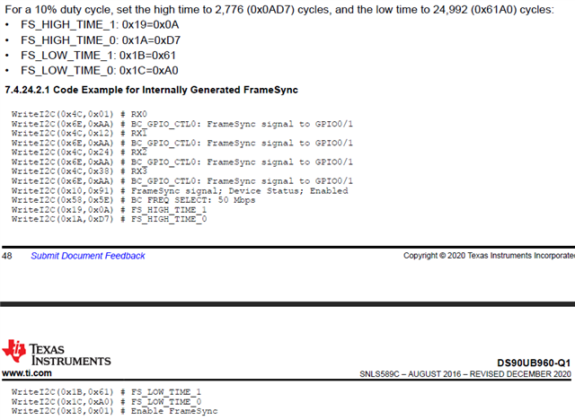

  • Hello Jacky,

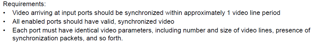

    In this configuration it looks like you are using Synchronous forwarding with line concatenation. Are you getting the same error "a non-synchronizable SOT (start of transfer)error interrupt during HS reception)" while using Best-Effort Round Robin CSI-2 Forwarding?

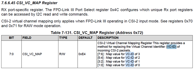

    Can you please clarify the following? Do all the imagers/cameras have the same VCID or different?
    What values are they setting in the above register?

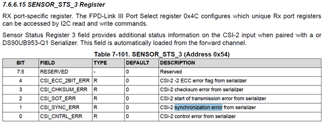

    What values do you read in the below registers (0x37, 0x54) ?

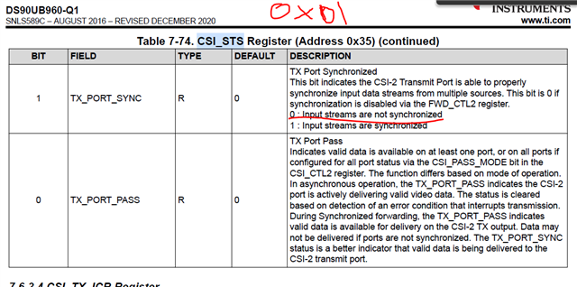

    There is an example code for internally generated FrameSync. Can you please try implementing it while using a synchronization based forwarding mode?
    Are there any other errors that are flagged in the 960 error registers?
    Shruti

    Customer will get the same error "a non-synchronizable SOT (start of transfer)error interrupt during HS reception)" while using Best-Effort Round Robin CSI-2 Forwarding, other comments kindly refer to below:
    1. CSI_VC_MAP is the default value 0xe4.
    2. UB960 0x37 register read back is 0x07. UB960 0x54 register read back is 0x00.
    Please refer to below all register dump for UB960 and UB953, please help to check if any issues.
    UB960 error register read back:
    UB953 register read back:
    UB953 register settings:
    Thanks.

    My suggestion would be to check if all the devices are synced. In your reply you said that reg 0x37 = 0x07, but in the register dump you shared, it shows 0x37 = 0x1. Can you please check if you are getting any IS_CSI_PASS_ERROR?
    Register 0x35-0x1 and looks like the input streams are not synchronized.
    Since you mentioned that the VCIDs of all four image sensors is the same, then I think you should try the Line-Interleave forwarding mode. "In this mode, all video streams must also have the same VC, although this is not checked by the forwarding engine. This is useful when connected to a controller that does not support multiple VCs. The receiving processor must process the image based on order of video line reception."
    Please note the requirements for synchronized forwarding:
    As of right now, in your register 0x21 = 0x3, you have synchronized forwarding disabled and round robin forwarding enabled. Round robin uses Virtual Channel ID to differentiate each video stream; but in your case, all image sensors have the same VCIDs.
    I hope this helps.
    Shruti
  • Hi Shruti,
    Thanks for the reply, we do checked customer's 4 camera's out, and it does not synchronized from below waveform, it is about 200us delay from camera 1 to camera 2. Customer wants to check what's maximum delay we can allow for UB960?
    Thanks.
  • Hello Jacky,
    you can refer to this E2E thread to get a better idea of the delay: https://e2e.ti.com/support/interface-group/interface/f/interface-forum/860039/faq-ds90ub953-q1-latency-of-ds90ub953-q1-and-ds90ub954-q1
    Also, as I mentioned previously,
    The video arriving at input ports should be synchronized within approx. 1 video line period.
    Shruti
