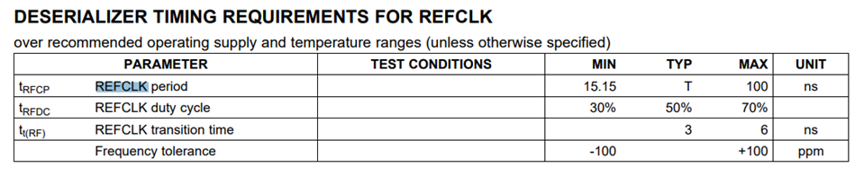

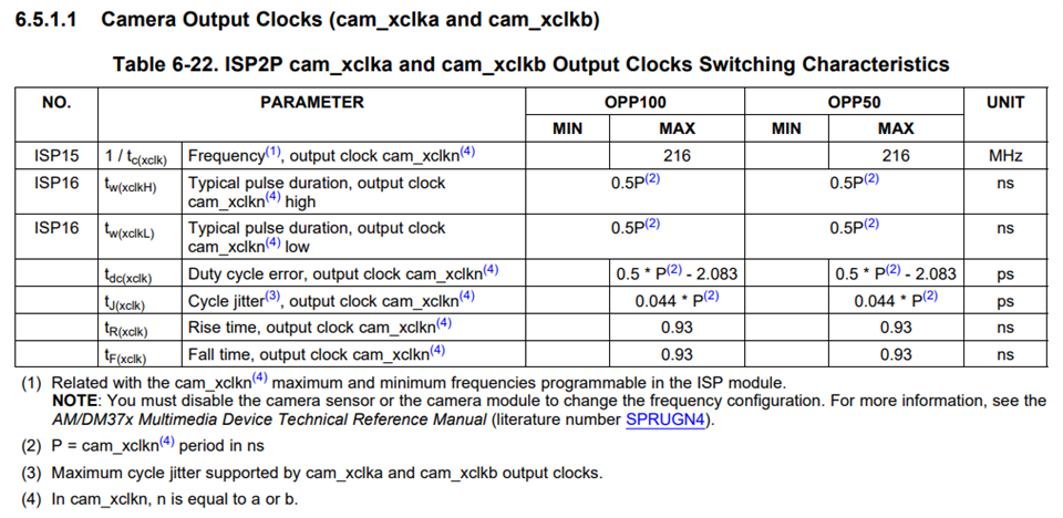

Customer is checking about the REFCLK of SN65LV1224. The input clock is from DM3730. It's output spec is below, could you help check if this clock could be used as reference for SN65LV1224?
DM3730 output clock spec:
SN65LV1224B REFCLK spec requirement:
