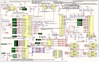

I am using TPS65982 to control charging modes for a USB-C device. This chip is new to me and I am currently going through the learning curve to make it operational. The Application Customization Tool GUI is being used to create a .bin file to program a flash chip (W25Q80) with SPI. I am able to get USB-C device charging at about 1.1A at 5V or 500mA at 12V but I cannot get a cable connection detected. The board is powered with 5V(VIN_Z = PP_EXT). PP_HV under normal operations should be 20V powered from a TPS55288 chip, but this also won't work. For testing I have bypassed the TPS55288 chip and have been providing 12V as source input into PP_HV. When I read the Status register, it is indicating that no USB connection has been made. It is also showing a fault on the PP_HVswitch. I believe a lot of the issues I am seeing are due to the lack of cable detection, and possible wrong GUI configuration.
Schematic, Register dump, and GUI settings are attached below.

Attached below is the Schematic for how the TPS65982 is connected.
