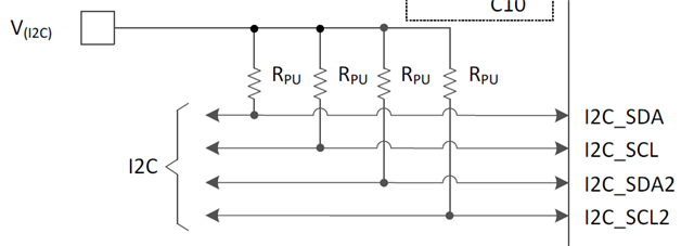

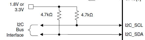

2) Does the I2C signal line is correct? Pls refer to the schematic design.

    2. Please add the recommended pull up resistors:
    962:
    935:
    3. The design is reasonable. Can you please specify what kind of support you are looking for? (schematic review?)
