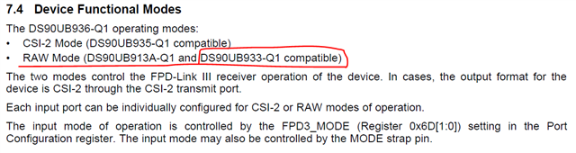

Can 933 be connect with 936? As I know 933 is a parallel port and 936 is mipi, does 936 need additional configuration of 933?
If not, plz help suggest an IC that can be paired with 936 at this case? THX
Please refer to below block diagram ,THX
  • Hello Kygo,
    Yes, we can pair the 933 with the 936 device.
    The following description is from the 936 datasheet:
    You will have to configure the mode strap and FPD3_MODE register setting accordingly. Please check sections "7.3 Device Functional Modes" in the 936 datasheet.
