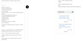

We found  1 module faulty due to IC SN65HVD252DR (RMICSE0122SCO) failure at  Mitsubishi Electric Pvt. Ltd customer end.
IC pins 1 (TXD) not getting required voltage.
Please find below for more details.

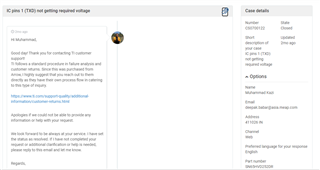

we already raised  case to TI portal, but instead  of any analysis report  case was closed by TI.
since supplier-arrow not having any idea for further processing.
please look into this matter and reopen the case once again.

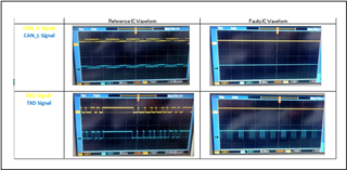

  • Dear Eric,
    Greeting of day!!!
    Please find MEI comments.
    1.MCU found ok once change with new CAN controller IC.
    2. We observed issue in RXD signal and CANH,CANL signals.
    3.Problem reported from field.
    Please check below waveform,
    looking forward for your kind response.
    Thanks & regards,
    Muhammad Kazi
  • Hi Muhammad,
    Thank for sharing the waveforms and extra information.
    It looks like in the faulty IC waveforms, the CAN bus is not responding when TXD is driven low. However, the CANH and CANL lines still rest at the propper recessive value (2.5V). In this setup, are there other transceivers connected to CANH and CANL? Or do CANH and CANL rest at 2.5V with only the faulty IC alone?
    Please confirm that the input to pin 8 (S or Silent) is low during this test. If S is high, the transceiver is in Silent mode and the CAN driver is disabled. In this case, I would expect the driver to not respond to a low on TXD. If the S signal is low and there is no response to TXD on the CAN bus, this is likely caused by a damaged device.
    Do you have any way of testing the individual failed IC outside of the system? Something like a TCAN1042EVM? I would like to see if we can validate the unresponsive behavior outside of the system. We can also conduct this testing in our office if we conclude that this is likely caused by device damage.
    Does the current schematic include any protection devices on the bus such as a TVS diode? If available, please share the CAN portion of the schematic. This can be done offline if needed.
    Eric Schott
