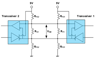

Currently, we are using the RS-485 communication circuit as follows.
One-to-one communication is applied, and the RFS and RT values of each transceiver are as follows.
RFS
RT
VAB
Transceiver 2
500Ω
120Ω
0.464V
Transceiver 1
620Ω
120Ω
Transceiver 1 uses the MAX491 and Transceiver 2 uses the SN65176B.
When the circuit is configured as above, the VAB voltage is output over 400mV.
When the fail safe resistor is equalized, RFS = RF1 // RFS2 < 375Ω, which is lower than the RCM voltage, and the maximum number of transceiver, n, has a negative value.

There are my Questions,
Q1. What kind of problem occurs when the VAB voltage value in idle state is output over 400mV?
Q2. What happens when the value of n (Maximum number of transceiver) is negative? Is it okay if the value of n is negative?
Best Regards
  • 1. The differential voltage must be at least 200 mV. You can increase the fail-safe resistors to 1 kΩ. (And check whether you really need fail-safe resistors at both ends.)
    2. This is not OK; it means that there is not enough drive strength for even a single transceiver.
  • Elaborate a little more on question 2. The maximum bus load is 375Ohm. Negative n means RB is to small => RB itself exceeds the max load.

    Then,  I'd like to ask some questions, below
    Q1. What is the maximum value of the  differential voltage, VAB?
    Q2. As shown in the figure above, when RT and RFS are selected as 12Ω and 620Ω, respectively, VAB voltage of 400mV or more is output in simulation.
           What problems arise when RT and RFS are selected as above? can i use it?
    Best Regards
  • 1. As shown in the recommended operating conditions, the maximum for this receiver is ±12 V. Other receivers have similar limits. In practice, you do not need to care about the maximum because it's larger than the supply voltage.
    2. In the idle state, any voltage larger than 200 mV is OK. (But you have to check all three states: idle, A<B, A>B).
  • What does it mean to check the three states? Are you talking about idle state, A to B, B to A communication?
  • I mean the A/B pins. RFS pulls A high and B low; when the transmitter is active and D is low, it drives A low and B high. If RFS are too strong, the differential output voltage might be too low.
