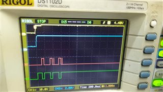

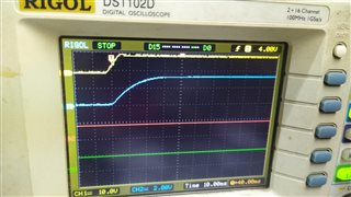

Checked the Oscillator Pin its show 1.8Volt.
Mode select as
PortPWR(41): 3.3V
GANGED(8): 3.3V
MODe(48): GND
We tried by connecting the 1.5K Resistor between DP0 andsDP0PUR
Even add the Oscillator series Resistor 1.K across Oscillator and XTAL2(44)
Please guide us to design USB hub. its show unknown device on PC.
