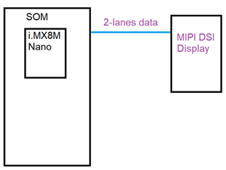

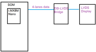

We're planning to use DSI-LVDS bridge, SN65DSI83 in our design. LVDS clock (A_CLKP/A_CLKN, output of DSI-LVDS bridge IC) frequency is 69MHz. What will be typical input clock (DACP/DACN) frequency at DSI-LVDS bridge IC?
Display module: 10” WXGA (1280x800) LCD panel
Question-2:
MIPI display: What is typical cable length (FFC FPC Ribbon Flat Cable) recommended for MIPI DSI display module?
In our application, display module requires min. 20 cm cable. Application processor is having MIPI DSI port. Is this better to use MIPI display module or LVDS display module (use MIPI-LVDS Bridge IC)?
