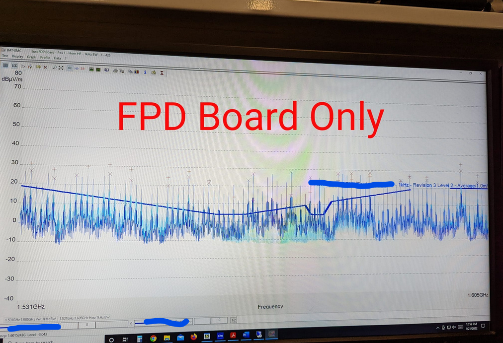

Hi Guys,
We are using in our camera serilaiser P/N DS90UB953.
We are in the stage of EMC testing.

we ran the test without the CSI port active. So only the link is active.
Regarding the frequency of the specific harmonic which is 753KHz, does this frequency familiar to you? Can it be related to PLL setup, equalizing, or something like that?

Hi Nick,
Let me specify the problem.
We disconnected the CSI transmitted to the "953" (separate boards), and still, we see the phenomena (harmonics).
What do you think?
Shay
Shay,
This ~750kHz harmonic is related to the FPD coding. See attached for explanation and suggestions on how to mitigate:
