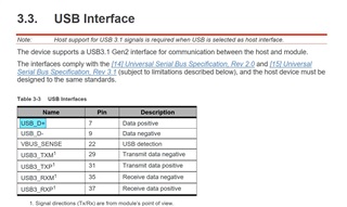

  • I checked. Unfortunately, one port of this hub will be connected to M.2 Wifi\BT module which needs USB 2.0 FS signals, but the other port will be connected to WWAN module which apparently needs USB 2.0 HS signals.
    they don't specify the speed for WWAN. I'm using Sierra EM9191.
