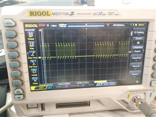

I’m Sanskar Verma, And I’m facing issues while developing a product using TCAN4550 for CAN-FD.
I am able to transmit and receive data with a delay of 1000 ms but if i am lowering the delay to 100 ms or below, all data packets don't reach the receiver. There is a significant loss of data while transmitting with a delay of less than 100ms.
I am able to receive all the data if there is a delay of 1000ms or more in CAN_Transmit. but my application demands no delay in transmission. I want to continiously transmit and recieve data from multiple nodes.
i'm attaching the all the 4 waveforms of SPI communication and the values of the registers 0x000c, 0x820, 0x0824, 0x0830 for your reference. Please look into it and let me know if you want any more information from my side.
CLK       nCS
CLK  CLK
    MISO
MOSI MOSI
Values of registers
0x000C = 30000a / 20000a / 8 / 804000e  (these values keep fluctuating randomly)
0x820 = 88 / 8a (these values appear mostly)
0x824 = 10105
0x830 = 809628ff
0x0800 = c84004a0

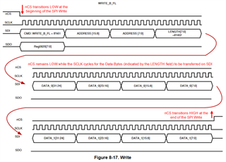

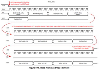

    What is the SPI data rate?  It looks to be approximately 3 Mbps from the CLK waveform.  Is that correct?
    The picture of your nCS waveform looks the same as the CLK waveform.  Can you provide a plot of the nCS so or verify it is High between SPI transactions?
    Can you provide a zoomed out image to capture the complete SPI data transmitted between nCS falling Low, and then going High again?  We need to verify there is the proper number of bits.  The TCAN4550 checks for the correct number of bits in a SPI transaction and it will generate a SPI error if it is not correct.  These bits are getting set in the Status register, so we need to figure out why.  How many bits are you transmitting between the nCS falling and rising edges?

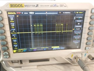

    I have attached the zoomed out image to capture the complete SPI data transmitted between nCS falling Low, and then going High again.
    SPI Data rate is 3mbps and i am transmitting 32 bits between the nCS falling and rising edges.
