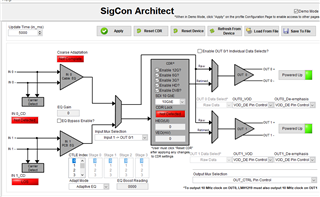

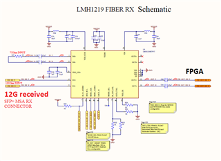

We have configured12G fiber 100-ohm differential input at IN1±(10GbE) channel and 100-ohm differential fiber output OUT1± channel in LMH1219.
We have used reference schematic of "'TIDA-00428'' and also find below screenshot of the our schematic design and setup block diagram.
When we used 6G in the same setup its work fine but when we used 12G at that time video came not came out properly.
We have also tried to override 10GbE with SMPTE video rate using few resisters write through SPI but still video not came out on 12G.
RAW FF 05 07 //Enable EQ core
RAW 31 20 30 //Power up OUT0
RAW 33 20 30 //Power up OUT1
RAW FF 04 07 //Enable lmh1218 core
RAW 3F 04 04 //Override reference rate
RAW 2F 00 C0 //Enable CDR lock to SMPTE rates
RAW 3F 10 10 //Override IN_OUT_SEL pin
RAW 31 03 03 //Select IN1 to OUT0 and OUT1
RAW 3F 08 08 //Override OUT_CTRL
RAW 09 00 20 //Disable independent output control
RAW 1C 08 0C //If locked OUT0/1 reclocked data else raw data
RAW 0A 0C 0C //Reset CDR
RAW 0A 00 0C //Release Reset
Could you tell me what is going wrong? Is it required any update in the schematic design or need to add more registers in the LMH1219 configuration?
