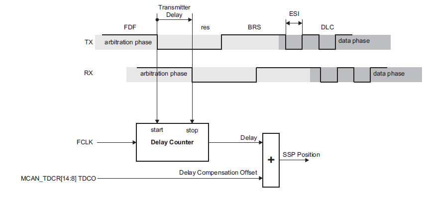

    1. Can you please clarify 'the delay between when a dominant signal is driven on m_can_tx to when the corresponding edge appears on m_can_rx, sampling every tq' by picture? I can't get the point.
    When a signal is driven on the TXD line of transceiver (integrated in this case), there will be some delay before that same signal appears on the RXD line (also internal here). This is due to the propagation delay of the transceiver, the time it takes to drive a valid bus state, and the propagation delay of the receiver. When operating at high CAN FD speeds, this delay can be a significant amount of time quanta (tq or clock divisor period used for bit sampling). Using a secondary sample point SSP allows the CAN controller to monitor this delayed signal and ensuring it corresponds with the data it is driving on the TXD line. This effect can somewhat be represented by the image below:
