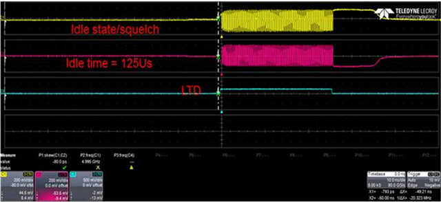

If the signal of PON interface is Burst type, our device (DS125MB203) can handle it or not? Customer is consulting about it. Thanks.

  • Hi Drew,
    Below two figures are the application reference. There are still two questions customer is concerned about:
    1. How long does it take for channel switching to stabilize?
    2. After the channel is stable, whether the response time from idle to data is needed? And no data loss is must required.
    In the meantime, do we have 1-lane solution similar function like DS125MB203? In customer system, they only need 1-lane one.
    Stanley

  • Hi Stanley,
    Apologies for the delay.
    The typical mux switch time is 100 ns.
    The typical response time from idle to data is 3.5 ns.
    Unfortunately, we do not have a 1-lane solution similar to the DS125MB203.
