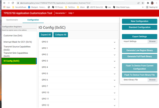

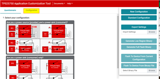

Anshuman,
The GPIO configurationis located in the Advanced Tab of the GUI.
If you click on the Advanced Tab you will see the screen change to look like this
Click on the configuration Tab
You can then click on the IO Config tab and the GPIOs will be exposed so you can edit them.
