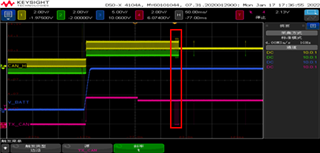

Then we found that whenever CAN_TX has data, the waveform of CAN+/CAN- will suddenly "shift" as a whole and then slowly return to normal
So when there is a lot of data, it seems that CAN+/CAN- signals suddenly appear, similar to the red area in the following figure:
Jiawei
  • Jiawei,
    Can you share a schematic? It looks like your device isn't powered but something else on the CAN bus is communicating, then when you power up the TCAN1057A-Q1, the CANH and CANL pins properly bias and the CAN bus rises to 2.5V. Is that what is happening here?
