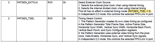

I have some question about internal/external pixel clock and video timing.
  1. As you can see below for 941 0x65 reg, my understanding is that if I use internal video timing, I can choose internal or external pixel clock, but if I use external video timing, I can  only use external pixel clock. Am I right?

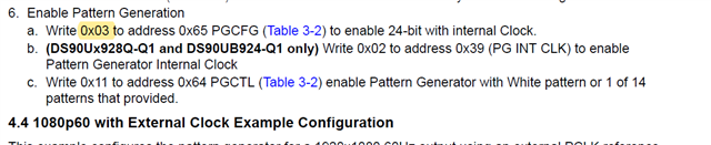

2.In the attached application note, section 4.3, it says "with the pixel clock and all timing signals generated internally". But the 0x65 reg value is configurated as 0x03. This makes very confused. I think bit2 should be "1".  What's your opinion?
BR,
Elec Cheng
