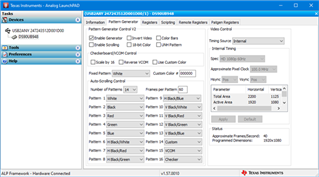

    I’m having problems getting a picture to my 2-port LVDS display (1920x1080) with the internal pattern generator of the ALP software (v.1.57.0010).
    With a smaller 1-port LVDS display (800x480) everything works, the pattern generator draws pictures nicely. The 1-port display uses only the signals on the J15 of the EVM.
    Switch S1 (MODE_SEL0) settings on the EVM:
    - 2-port LVDS display: S1.5 on, all other switches off
    - 1-port LVDS display: S1.7 on, all other switches off
    ALP Setting for the 1080p display: Internal Timing, Spec: HD 1080p 60Hz
    This is the only setting that gives me some kind of picture. With all the other setting I just get a black screen.
    Any other fixed pattern than white or blue gives me a black screen. The white pattern gives kind of a white screen, but there is some interference running on the left edge, like this
    The blue pattern gives a greenish screen with lots of interference running across the screen.

    Here’s my ALP settings
    Niko

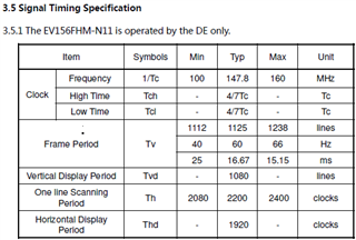

    One other thing, can you also attach the actual display timing parameters of the panel you are connecting to?
    Logan
  • Hi Logan,
    Thanks for you help! Here’s the signal timing specification from the datasheet. The datasheet can be found here, if you need some other details:
    https://www.data-modul.com/sites/default/files/products/EV156FHM-N11-specification-12047755.pdf
    Niko
  • Hi Logan,
    I noticed that the minimum pixel clock of the display is 100 MHz. Which is the maximum that the DS90UB948-Q1EVM can supply. Could it be that the EVM cannot quite deliver the minimum of 100 MHz, and that's the reason why the image is not synchronizing? If I set the pixel clock in ALP to lower than 100 MHz, I always get a black screen.
    Niko
  • Hi Niko,
    This might be the case. As described in this application note on PatGen, the frame rate will vary while the video timing is forced.
    Are you able to set video from a SER with proper video timing, or use external CLK?
    Logan
