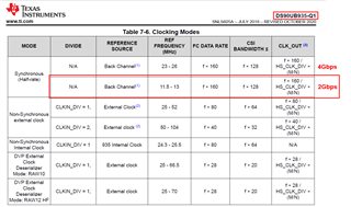

Below picture is my board hardware design,
For DS90UB954/953, DS90UB936/935 application, to transfer I2S signal, I found the document
https://www.ti.com/lit/an/snla314a/snla314a.pdf?ts=1644823849836&ref_url=https%253A%252F%252Fwww.ti.com%252Fsitesearch%252Fdocs%252Funiversalsearch.tsp%253FlangPref%253Den-US%2526searchTerm%253Dfpd-link%2Biii%2526nr%253D38
The document shows when using 4Gbps line rate, the Maximum Recommended Forward Channel GPIO Frequency (MHz) is 5MHz.
So if I use 2Gbps line rate, will the Maximum Recommended Forward Channel GPIO Frequency (MHz) be 2.5 MHz?
The SCK clock of my application is 2.048 MHz, we want to know if it's ok for 2Gbps line rate.
Thanks.
    Is there a 2Gbps table could be referenced? thanks.

    I am not clear on what mode your application line rate is, but if you for example, operate in Non-Synchronous mode and use a 25MHz external reference clock for the serializer, then the FC line rate will be 2Gbps (See Table 7-6. Clocking Modes in the UB935 datasheet for more details).
    In the case where 4 GPIO pins are being sampled, each GPIO is actually sampled every 5 FC frames because of the internal DCA scrambling and encoding sequence on the UB935. If the system is running a FC rate of 2Gbps and 4 GPIO pins are being sampled:
    2Gbps / (40-bits per frame * 5 frames) = 10MHz (Sampling frequency)
    Max frequency of signal sampled at GPIO pins = 10MHz/4 = 2.5MHz (x4 oversampling)

    Thanks for your quick reply, I'm using synchronous mode, back channel 25Mbps, will the result is the same as you explained?
  • Hi Chris,
    Yes, the results will be as I explained.
    Since you are sampling at the Serializer GPIO and sending the data to the Deserializer, then the Forward Channel line rate will determine the sampling rate of the GPIOs. We recommend x4 oversampling, so the max recommended signal measured will be 2.5MHz, when 4 GPIOs are sampled on the Serializer GPIO pins.
    Also, here is a related E2E thread about how you can set the 953/954 to operate in Synchronous mode with a FC rate of 2Gbps. REFCLK at the 954 deserializer needs to be 25MHz, but if you lower the BC rate, the serializer will operate with a FC line rate of 2Gbps.
