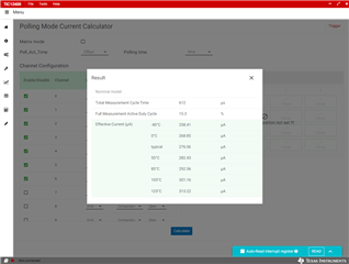

  • 4. Could you advise how much is the maximum current calculated by EVM GUI tool below?
    +10% from typical value below is enough?

    For your current estimation question, the GUI calculator basically sums up the typical current in polling mode across all of the inputs during an entire polling cycle. It doesn't take into account factors that arise due to external components. Your worst case for ambient could be a lot higher and is difficult to characterize easily, particularly at higher temperatures.
