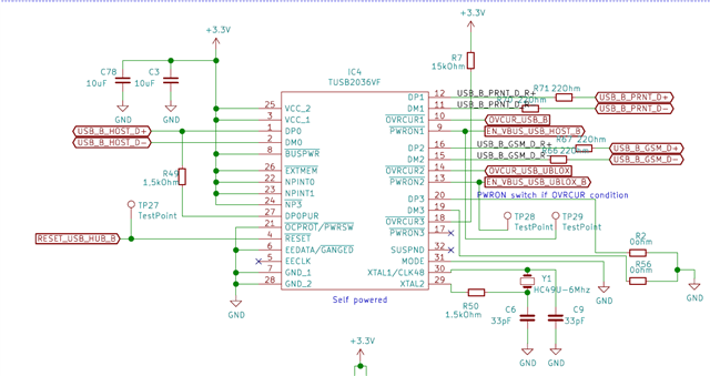

Hi Team,
We would like to ask your help regarding the issue with TUSB2036 on our customer's board. According to our customer,
I have a board based on a sama5d27 som1 from microchip and it's based on an embedded linux. On it, i have a usb device and a usb host.
When i put the hub on the board, the usb device is not working at all anymore. I get an enumeration issue but when i remove the hub,it perfectly works.
Not sure about the NPINTx and NP3 pins implementation
Danilo

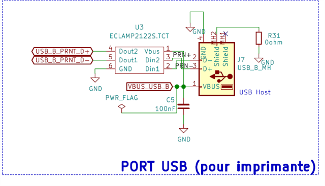

    15k pulldowns resistor are present as you can see on the attached file (resistors are in the component U3 : https://www.mouser.fr/datasheet/2/761/SEMT_S_A0000305173_1-2575604.pdf).
    And there are also 22ohm series resistor.

  • HI Danilo,
    Where is the USB device being connected to when it cannot enumerate?  Is it possible that the VBUS is drooping (below 4.5V) and causing enumeration issues?  The TUSB2036 is configured as a 2 port hub with permanently connected devices, that looks correct based on the schematic.
    USB hubs can only be connected to a USB host on their upstream port (DP0/DM0), the other ports only support device connections.
    JMMN

  • Hi Danilo,
    NP3/ pin enables or disables Port 3 of TSUB2036 - in this case it is disabled.
    NPINTx pins set if the ports are permanently attached or not.  Permanently attached means that there is a device hardwired to the port - so that it will always be there.  Unattached ports are exposed connectors where maybe a device is connected, maybe it isn't.  Functionally, it will not have much system impact.
    So the customer SoC has 1 host port  and 1 device port.  The customer connects the TUSB2036 to the host port of the SoC, creating 2 host ports from the 1 host port.   This all works, correct?  The problem is that the SoC device port doesn't work when the hub is used?  If that is the case, it is likely a SoC software issue.

    This is what microchip said about the hub : " Also, did you check with Texas Instruments for the hub implementation? I think the implementation should be verified by them as well, I briefly checked and I am not sure about the consistency in NP3/NPINT0/NPINT1 assignment, as well as tying pins DP3 and DM3 to ground. Could you please check it?"
    Danilo
  • Hi Danilo,
    The customer can try setting the NPINT0/1 pins to 00, but functionally the hub will work either way.
    JMMN
