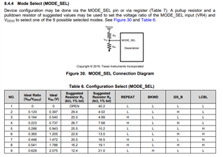

Good Day. Customer have a serializer DS90UB947 and trying to connect to deserializer DS90UB928. Could you please provide me configuration information for DS90UB928? Please advise. Thank you very much.

Hi Ray Vincent,
Please see the attached DS90UB928 EVM User Guide for some guidance on the configurations for the DS90UB928. The main configuration required is the MODE_SEL, I am attaching a screenshot of the MODE_SEL configuration from the 928 datasheet. The customer just needs to strap both the 947 and the 928 to their desired compatible functions.
