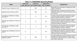

in my design I'm using SN65DSI84 and verified that display connected on channel A is working. I connected other display on channel B but this one shows no image (I verified also signals and they look too weak).
To display on both channels I've set resister 0x18 clear bit 4. DO I need ot do some other setup? Thanks.
