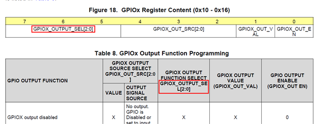

  • Hi Justin,
    Thanks for your quick reply.
    One thing to note, you seem misunderstanding the table 8, the bits order is by figure 18, so 0xd1 is not reserved, it's "Device interrupt active low".

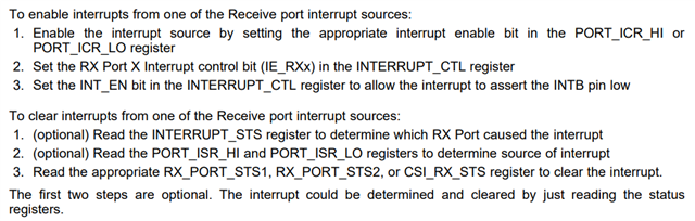

  • Hello Chris,
    You are correct. I seem to have gotten mixed up for a second. If you set reg 0x13 = 0xD1, then your understanding is correct. However, since you wish to use GPIO3/INTB as the interrupt, then the instructions in section 7.5.8.2 FPD-Link III Receive Port Interrupts can be followed instead:
    1) First, select the Rx Port to write to in reg 0x4C. Then, perform the following.
    The IE bit that could be set in register 0xD9 is the IE_LOCK_STS bit. Once this interrupt is triggered, there are a number of registers that can be read, such as the CABLE_FAULT bit, to check for the error. See 7.4.11.3 RX Port Input Signal Detection in the datasheet for more details.
