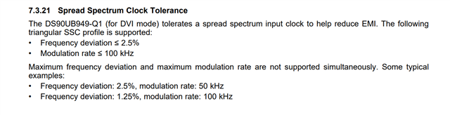

I would like to know, can 949 support spread HDMI input clk from SoC? Below description is related with HDMI input clk, right? Thanks!

Hi Elec,
This is question from a customer? If so, can you share which customer and what SoC they are using?
The HDMISSC is actually not supported, this was a typo in the datasheet and will be updated in the next revision.
Shu

Hi Elec,
There are very few SoCs that support SSC on HDMI interface. SoC 8155 only has DP and DSI so I am not sure what the goal is here.
