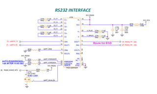

Part Number: TRS3122E
Could anyone help to provide the information regarding the current consumption performance under Static and Off mode?
The datasheet shows the number of it but our TEST CONDITIONS are different, e.g. the /FORCEOFF and the FORCEON pin.
And our test result is 4.4mA at idle mode and became 0.3mA 30 seconds later.
Could anyone help to clarify it?
Thanks.
Our schematic is below.
From the datasheet
