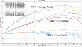

Hi Team,
Customer is consulting what's the exact boost up value at 2.5GHz, could you pls help us look at this? Below D/S figure is not so clear. Thanks.
Stanley

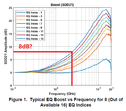

Hi Nasser,
But I see in our D/S shown in below, which is near around 8dB at 2.5GHz. Why are there some difference here? Thanks.
Stanley
Hi Stanley,
Apologize since i was viewing another part's graph. Please note below. This is actual measurement and it is about 8-10dB at maximum.
Regards,,Nasser
