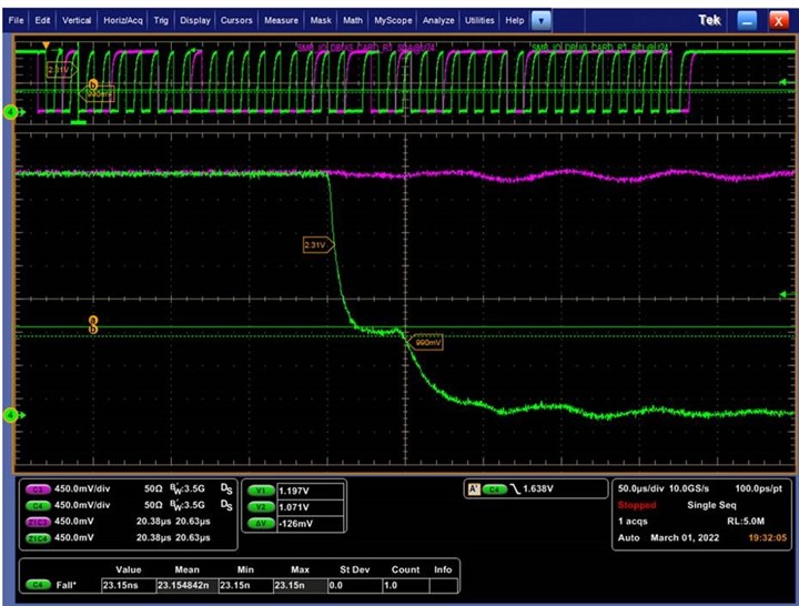

  • Hi Bobby,
    We detected a unsolvable non-monotonic waveform when we tested SMB CLK signal at TCA9555PWR(write mode, write from BMC to TCA9555PWR with a long-open cable). So customer would like to know if TCA9555PWR CLK pin design with Schmitt trigger.
    Hardy
  • That step in the signal is likely from a Pass-FET on the I2C bus. I'm willing to bet your system has some kind of pass FET level shifter or I2C switch/mux causing the short step on the signal. Since it seems like your fall time is stated to be ~23ns, the step is likely short and lower than the 50ns so this shouldn't cause issues in an I2C bus (or our device).
    -Bobby
