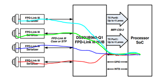

When trying to communicate to multiple cameras over the backchannel, how should the datarate be calculated starting from the SoC?
Basically, all the data will have to share the same I2C pipe between the SoC and the DES, but then after that, it gets fanned out to the different backchannels, correct? So how does the math work out there to calculate how long communication could potentially take?

  • Hello Jared,
    this is correct that the data will have to share the same I2C pipe between the SoC and the DES, but after that it will be forwarded to the different SER over the different BC using:
    1) Either in series, i.e. communicating with one Camera at a time, then to the next and so on,or
    2) Use the Broadcasting mode by forwarding the exact same initialization to all 4 Cameras (this can be used for initialization at the begining).
    So, for normal communication, you are using the first method, which forwards the I2C in series not simultaniously.

  • Hello Jared,
    The approximate effictive bit rate, including latency timings across the control channel, can be calculated by the following formula:
    9 bits / ((Host_bit * N) + (Remote_bit * N) + FCdelay + BCdelay); where N = Number of I2C bits sent over one frame.
    For the 953/954 if using the 400KHz I2C rate, then the effictive bit rate would be:
    9 bits / (22.5us + 22.5us +0.01us+1.2us) = 194.76 kbit/sec
    If using the 1MHz I2C rate on both sides, then this would result in an effective bit rate =
    9 bits / (9us + 9us +0.01us+1.2us) = 468.5 kbit/sec.

  • Hello Jared,
    The effictive bit rate is the same for both above methods.
