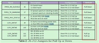

3. See the attachment for the default state of the strap pins configuration of phy;
4. After the daughter board is powered on, configure the FPGA, the OUT_ENABLE signal of the output phy is always high, and the RESETN signal of the phy is released; 5. It is found that the PCLK output of phy is abnormal (see the attachment), and the ULPI_CLK is brought to the test point and observed to be 120MHz (see the attachment).
