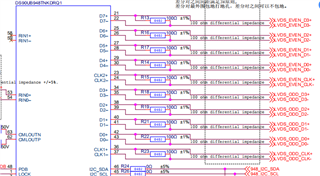

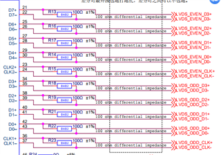

    In DE only mode, I measured the lvds signal waveform output by the 948 as shown in the attachment, the amplitude does not seem to be very stable, does the 948 have the ability to enhance the lvds drive? If I want to turn into Sync Mode output, what do I need to do besides writing 0x80 to register 0x29?
    Luuel
    948_LVDS.rar

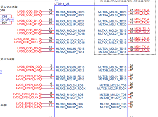

    Below is the circuit diagram of the 948 output
    LVDS TO MIPI
    I found that if I reset the lcd screen, the display briefly shows a 2 equal division soc output video, is this related to the problem I am experiencing now?
