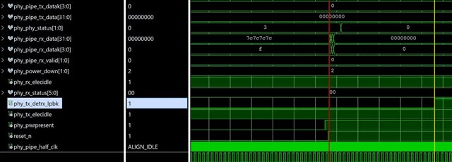

Using TUSB1310, for a USB3.0 device, after plugged into PC, I find that PHY_STATUS, which should be asserted for receiver detection, doesn't go high.
Strap/Drive signals:
1. VBUS is high
2. TX_ELEC_IDLE is 1
3. TX_LPBK is 1
4. TERMINATION is 1
5. RATE is 1
6. TXONESZEROS is 0
7. POWER_DOWN is 2'd2
8. PHY_MODE is 2'b01
9. RX_POLARITY = 0
10. TX_DE_EMPHASIS = 2'b
11. TX_MARGIN = 3'b000
12. TX_SWING = 1'b0
13. TX_ELASTIC_BUF = 1'b0
14. OUT_EN = 1
Reset is normal. After PHY reset, PHY_STATUS got asserted and then deasserted which is as expected. TX_LPBK is asserted, but no one clock PHY_STATUS.
Observed RX_ELEC_IDLE de-asserted periodically.
Please help,
Thank you,
ET
