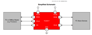

    And let me explain the problems I have with the TCA9517
    First ,TCA9517 IBIS model includes  0.9V, 3.3V, and 5V opreation on side A only.
    But 1.8V operation is used in our design.
    Second,TCA9517 IBIS model doesnt have series model.
    could you help me to fix this issue?

    and now we are suggest another way
    We think this part does not have a series model because the voltages of his A SIDE and B SIDE are separated (as shown below).
    For example, the current VCC A is 1.8V, while VCC B is 3.3V, and the two are not affected by each other (there is no SERIES MODEL),
    Taking PIN2 to PIN7 as an example, I can start measuring directly from PIN7, so that I can avoid the problem that A SIDE does not have 1.8V operation.
    Would you like to ask if this understanding is correct?
    if there have any idea, please share with me
    thanks
    Tommy
    You're correct. This device is a redriver, it does not have a pass FET architecture so there should not be a series model for the device. The IBIS simulation tool should treat this device as some kind of push pull driver on A side assuming you pulled the TCA9509 structure and then treat the B side as some kind of open drain driver.
    -Bobby
