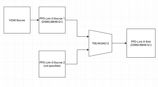

We are using the DS90UB949A-Q1 to convert HDMI to FPD-Link III which is then sent to a remote Deserializer connected to a Display. In order to be able to switch between multiple video sources we are using the TMUXHS4212 as shown in the picture below:

My question to you is if you have any idea what could cause this sporadic behaviour, especially after the fact that the boards were initially working fine and there were no changes made to them. Could the mux cause problems in terms of signal integrity even tough we payed careful attention to the correct design of the transmission lines?

    To eliminate the switching source of the mux, did you try to connect directly from 949 to 948? Which type of CMC are you using? Murrata? I noticed that the CMC is very sensitive. Can you try to probe across the pin if there is any short by probing pin 1-2, 3-4, and 1-4?

    The issues seems to lie with the MUX. After removing it and bridging the pins on one of the boards that wasn't working anymore, we could immediately get a connection between the 949 and the 948 with a clear picture on the display.
    Do you have any experience with the TMUXHS4212 in FPD-Link III switching applications, or would it be better if I closed this thread and opened a new thread specific to that device?
