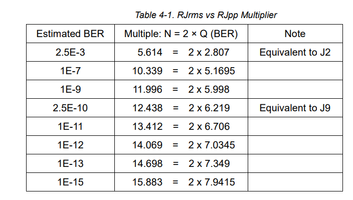

    • Total jitter (for a given probability level = deterministic jitter (DJ) + sigma_RJ*N where N is  the probability factor
    • Deterministic jitter will not change with probability level
    • The customer would need to measure the random jitter sigma value (sigma_RJ) for their system then they can multiply it by the N value corresponding to the target BER level

    • Total jitter (for a given probability level) = deterministic jitter (DJ) + sigma_RJ*N where N is  the probability factor
    • For your spurce in question you would need to perform a jitter measurement of DJ and RJ_sigma using the scope method (or other method) then perform the calculation. Most new scopes like Keyshight DCA-X do this for you
    • You may refer to the application note from Anritsu per link below to familiarize yourself with jitter methodology

    Yes, you would need to measure DJ and RJ to perform the calculation. The customer simply needs to measure their system DJ and RJ and ensure the TJ is within 0.4UI; it should not be that complicated.
