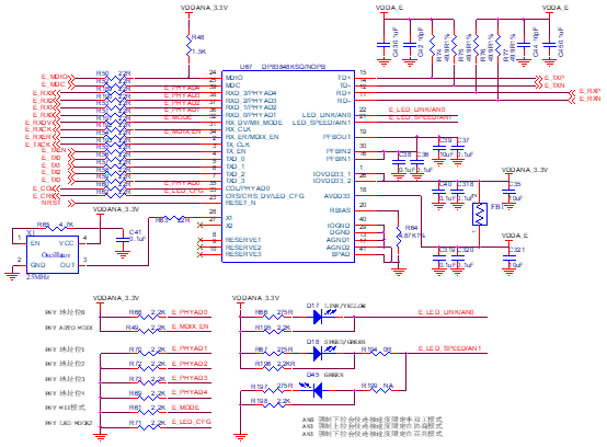

Dears
         DP83848 Connection speed indicator is steady on,Chip communication and speed sub negotiation are normal.But after unplugging the cable,The SPEED indicator of the PHY chip is steady on,MII interface mode: The hardware configuration is 100 GIGABit sub-negotiation full-duplex/half-duplex compatibility mode
