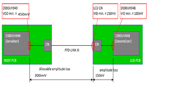

We have a loss in the Host side PCB + cable loss value is negligible approximate of 0B and Deserializer PCB loss of 5.2 dB. Totally we have a margin of 4dB to 5 dB between serializer and deserializer.
We used dual port coax mode.  So consider the amplitude is 900mV /2 = 450mV transferred over the cable.
We would like to increase the gain of the de-serializer by enabling the AEQ. Please let me know the best setting for the equalizer.
DS90UB949A  - DS90UB948
Specifications Min Typ Max Unit
Vout from DS90UH949A 400.00 450.00 650.00 mV
Host Side PCB loss - 150mV 0.00 0.00 0.00 mV
Host Side PCB data 400.00 450.00 650.00 mV
Cable loss 0.00 0.00 0.00 mV
After cable 400.00 450.00 650.00 mV
Display side PCB loss 250.00 250.00 250.00 mV
Available Margin 4.08 5.11 8.30 dB

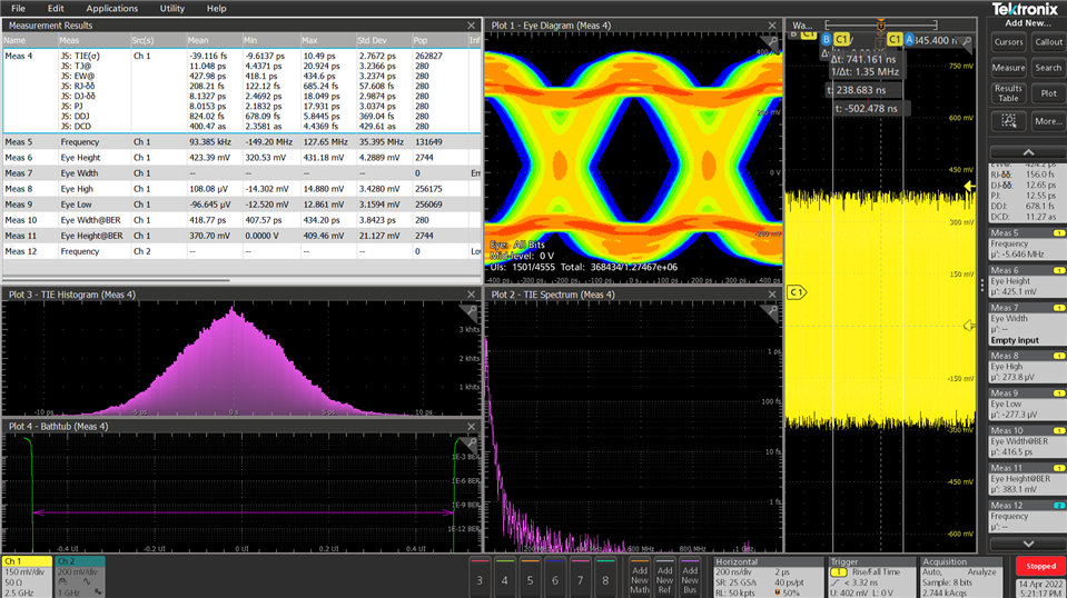

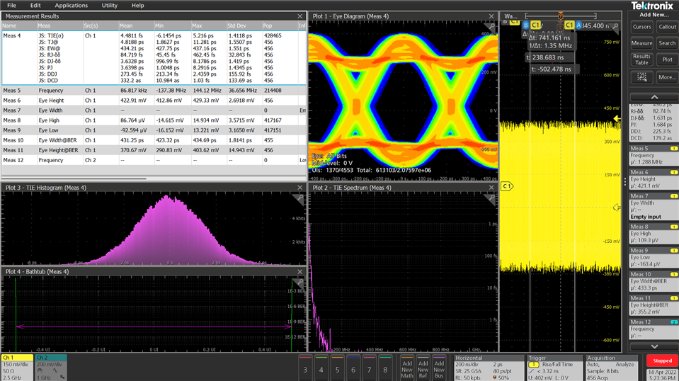

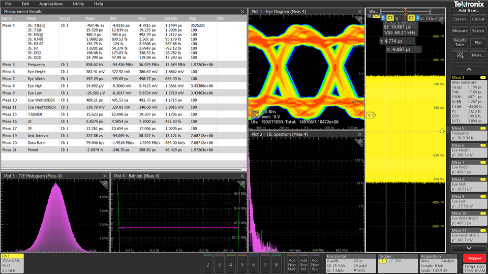

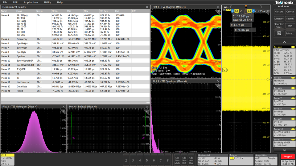

  • Hi Casey,
     Please find the Jitter measurement scope images in the attachment. The scope settings followed from  DS90UH/B949 Jitter Measurement Criteria revision 1.0 document.
    949 Jitter measurement
    947 Jitter measurement
    Selva
